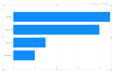

I've got the data into PBI on a bar chart now, but I can't seem to get it looking like yours, where it has the merged header then the two columns for pass and fail showing. It either shows one or the other depending on what's on top on the Axis field.
Thank you so much again for your time with this. I'm sure there's an obvious answer staring me in the face with this!
Glad you were able to get the results you needed. Power Query is incredibly useful in transforming 'lemon' spreadsheets into 'lemonade'.
For your chart, I set up the fields as follows...
which gets...
click on the 'Expand all down one level...' icon to get...
Cheers.
