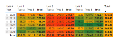

Thanks for your help! Actually I marked this as solved but did not realize there was one more criteria that the PBI Matrix wasn't doing. In the Excel table the conditional formatting gradiant is done per column. But if I try to format the matrix as specified above, it does a gradiant for every cell. Is there a way do have each sub column (the Type column and the total columns) be indepent in it's formatting?
E.g. this is what I see in PBI
This is what I want in PBI:
