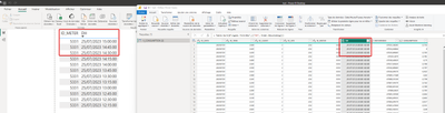

I use a SQL Server database to store values. My datetime is in UTC. I want to show the date as locale ("Western Europe") and i'm using direct query (import is not an option).
I wanted to keep it simple so i created a view on my table and used the SQL "at time zone" function
DH AT TIME ZONE N'W. Europe Standard Time'
 Works pretty well and in power query i got my datetime with the correct offset.
But in the report, i want to see the offset applied and i'm unable to find how to achieve this.
Example in the following screenshot, i want to show "25/07/2023 17:00:00" and not "25/07/2023 15:00:00" :
Any hints?
Thanks a lot!

In my country we have a daylight saving in summer/winter so sometimes it's duration + 1 and sometimes it's duration +2 so your solution won't work for my use case.. 😞
