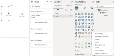

Ok how about I run through a simple version of what I'm trying to do to hopefully make it clearer:
1) Create a csv similar to this with several events and multiple dates for each (date overlap between events is fine)
2) Open PowerBi Desktop and create a new blank report
3) Get the csv data, both columns should come through in the format date and text automatically but feel free to double check
4) Setup the following 2 data cards
With all of that setup, my question now is how do I create a third data card which dynamically adds the result of the previous 2 data cards (6+19 in the current case), so that if the data is updated later with more events and more dates the third data card will automatically total both of them each time.
