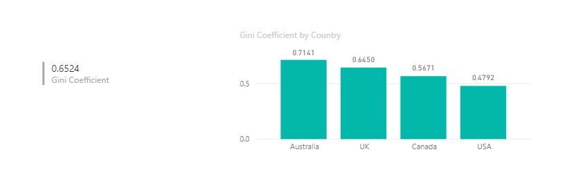

If we have a table ("IncomeTable") which contains a column with the data by individual:
And if we add this measure to the data model:
(Note: adjust row 2 so that SELECTCOLUMNS points to the column that contains your data)
Gini Coefficient2 =
VAR DataColumn = SELECTCOLUMNS(IncomeTable,"Data",IncomeTable[Income])
VAR Areas_Under_Lorenz_Curve =
    ADDCOLUMNS (
        DataColumn,
        "Area",
        VAR IteratingIncome = [Data]
        VAR LessOrEqual_Table =
            FILTER ( DataColumn, [Data] <= IteratingIncome )
        VAR LessOrEqualCummulative =
            SUMX ( LessOrEqual_Table, [Data] )
        VAR Less_Table =
            FILTER ( DataColumn, [Data] < IteratingIncome )
        VAR Less_Cummulative =
            SUMX ( Less_Table, [Data] )
        VAR TotalIncome =
            SUMX ( DataColumn, [Data])
        VAR NoOfDataPoints =
            COUNTROWS ( DataColumn )
            DIVIDE (
                DIVIDE ( LessOrEqualCummulative + Less_Cummulative, 2 ),
                TotalIncome * NoOfDataPoints
    ( 0.5 - SUMX ( Areas_Under_Lorenz_Curve, [Area] ) ) / 0.5
Then your report will calculate gini coefficients at any filter level:

Hi @palkamj,
This is definitely possible.
Gini Coefficient2 =
    ADDCOLUMNS (
        DataColumn,
        "Area",
        VAR Less_Table =
        VAR TotalIncome =
            DIVIDE (
