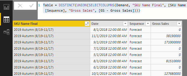

  • Hi hidenseek9,
    I get it now. Try these table formulas, please.
    Table =
    DISTINCT (
        UNION (
            SELECTCOLUMNS (
                Demand,
                "SKU Name Final", [SKU Name Final],
                "Date", [Date],
                "Sequence", [Sequence],
                "Gross Sales", [Demand Cab]
            SELECTCOLUMNS (
                'PL by SKU',
                "SKU Name Final", [SKU NAME],
                "Date", [Date],
                "Gross Sales", [GS - Gross Sales]
    Or,
    Table =
    UNION (
        SELECTCOLUMNS (
            Demand,
            "Date", [Date],
        SELECTCOLUMNS (
            'PL by SKU',
            "Date", [Date],
    How-to-append-calculated-column-from-one-table-with-another-table2

      • v-jiascu-msft's avatar
        v-jiascu-msft
        Hi hidenseek9,
        Table =
        DISTINCT (
            UNION (
                SELECTCOLUMNS (
                    Demand,
                    "Date", [Date],
                SELECTCOLUMNS (
                    'PL by SKU',
                    "Date", [Date],
        Or,
        Table =
        UNION (
            SELECTCOLUMNS (
                Demand,
                "Date", [Date],
            SELECTCOLUMNS (
                'PL by SKU',
                "Date", [Date],
        Dale
