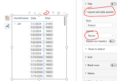

Hi @swathiG  Go to layout and style and set layout to Tabular or outline. Follow red highlighted steps.

Hi, @swathiG , folow these steps:
1. Make sure to put fields that you want in rows:
2.In visual format, go to Layout and Style Pressets and change the layout to tabular, and the active toggle button to repeat headers as shown bellow:
3. Now you can Expand all down levels in the hierarchy as shown bellow:
4.Now your Matrix should look like this:
To learn more about Matrix, please follow the link: Matrix visual format settings
If this help you, please give a Kudo and mark as solution
