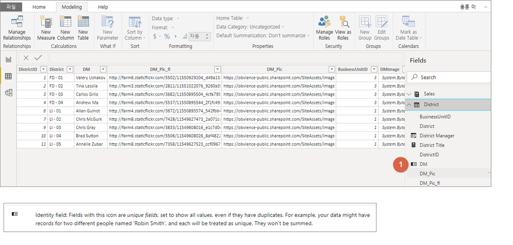

How can I declare a field as Identity field?
How can I declare a field as Identity field as picture below?

If you means to create unique id in power bi, it is possible as long as for the same name(different people), there are different values in other columns.
You could create index column with DAX as below:
https://community.powerbi.com/t5/Desktop/Create-unique-ID/td-p/677570
For example,create a column below:
Final Rank =
RANKX (
    Table,
    RANKX ( Table, [Primary column],, ASC )
        + DIVIDE (
            RANKX ( Table, [Secondary column],, ASC ),
            ( COUNTROWS (Table ) + 1 )
rank as unique id =
RANKX (
    'Table (2)',
    RANKX ( 'Table (2)', [name],, ASC )
        + DIVIDE (
            RANKX ( 'Table (2)', [column1],, ASC ),
            ( COUNTROWS ( 'Table (2)' ) + 1 )
        ),,ASC,Dense

- You can go to the visualisation pane, right click on the field and choose not to aggregate. Then it will be spread at least across all distinct values of that column.
- If you create an identity column already in TSQL or if you make it in the Power Query Editor (by the way, you can make the new column an index column in Power Query), you can choose "no aggregation" for that column in the visualisation pane as well, and by that, you will spread the table across all rows.
- If you have a column that already is an identity (unique in each value of the column), then you can just as well choose in the visualisation pane "not to aggregate" that, without the need to make a new identity column.
Here is how you set a column to "do not aggregate" in German:
