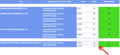

I have a matrix where the rows are being grouped as they have the same data but I want to stop it grouping. I have added the index column which has worked but I want to hide the index column is this possible.
Without the index column it looks like this -
but there are two coursework worth 50% with the same hand in date and different marks so it needs to look like this
but not have the index column. I have just rezised the column by dragging it but it then makes all the rows to big and unreadable on the matrix.
is there a way to hide the index without getting this result.
any help is appreciated.
thanks
  • Hi WJ876400 ,
    You can try below options.
    Option1: Keep Index but make it transparent
    Instead of removing the Index column, keep it and make it invisible or appear blank:
    1. Go to the Format pane of the Matrix visual.
    2. Expand the "Field formatting" section.
    3. Choose the Index column.
    4. Set the Font color and Background color to match the matrix background (e.g., white or transparent).
    5. Optionally, reduce the column width as small as possible.
    This way:
    • The matrix will not group rows (because Index is still present).
    • The column won't disturb readability (effectively hidden).
    Option2: Use Table visual instead of Matrix
    If you do not need subtotals/grouping logic:
    • Consider using a Table visual instead of a Matrix.
    • Tables don’t group identical values the same way as matrices.
    • You’ll still be able to sort, format, and even hide the index more cleanly.
    Option3: Create a Composite Key Column
    Instead of showing the Index, create a new column like
    UniqueAssessmentKey = Unit & " | " & 'Assessment and Hand In Date' & " | " & Index
    Use that in the Matrix Rows, and then apply the same formatting trick (hide font color) or truncate using a measure to only show meaningful parts.

  • On a Table visual, you can right click on the value column and select "Do not summarize".
    There is no equivalent functionality on Matrix visual.
    I therefore suggest that you create a measures and use a Table visual to acheive you desired output.
    I want to help you more but your description is too vague. Please write it again.
    You will get a quicker and better response without misunderstandings if you put time and effort into carefully writing a clear problem description with example input and output data. Look forward to helping you when this information is forthcoming
