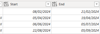

in my case, i created a multiple date in power query because in power bi you need a value in those days to be filled.
from this value
becomes this value
using this m-code
Table.AddColumn("Previous Step", "Custom", each Table.AddColumn(#"Filled Down", "Custom", each {Number.From([Start])..Number.From([End])}))
then you can plot in matrix visual to get that values in between two dates.
Hope this will help.
Thank you.
