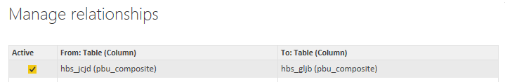

Ok, I've made it a bit further. I completed the steps mentioned above. I created a composite key of project, building, and unit. I added this to the "parent" table:
I also created the same on one of the tables I want to drill to and added it to the view:
I created a relationship between the two tables using the composite key:
I added the composite key to the Drillthrough filters section on the "child" page:
But when I right-click on the "parent" report, I don't seem to get the drillthrough menu. I'm sure I'm doing something silly. If you have any insight, it would be much appreciated.
Thanks.
Everything sounds correct so far, so here's a couple of things to check:
First, make sure you have a relatively up-to-date version of PowerBI.  Always best to be on one of the latest 2 or 3 versions.
Second, make sure that the field you put in the Drillthrough Filter box is from the *parent* not the child table (I'd wager it's going to be this one).
If that still doesn't work, see what happens when you make the filter "bi-directional" between the child and parent tables in the model.
Finally if it's still failing, is there any way you can share the PBIX with cleansed data? Any of the common file sharing sites are generally used by people to share their files.
Hope this helps
David
You were right. It ended up being the drillthrough I was using was the one from the child, not the parent.
I truly appreciate your help.
