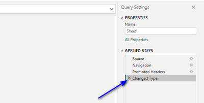

Help! Power BI reads dates from Excel as numbers
Hi All, 🙂
When I import data from my Excel workbook, Power BI reads the dates as numbers, see below
Tried to change the data format to Date and to play with the locale, but no luck!
Please help 🙂
  • Hi i96_md
    First change the datatype to number since it is being imported as a string.  (as in original post)
    After that you should be able to change the type to date.  It will ask if you want to replace the current step or create an additional step.  Select Additional step.

  • PijushRoy's avatar
    PijushRoy
    Hi i96_md
    After promoted header, their are one Step added by default "Change Type"
    Please delete the step and try to change data type as Date

    • i96_md's avatar
      i96_md
      Hi PijushRoy,
      Thakns for your support!
      Here are the steps applied:
      I did unpivoit the columns to have all dates in one line and becasue Power BI reads dates as numbers, they are unpivoted the same way ðŸ˜¥.
