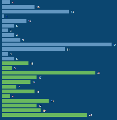

I have the following chart:
 - X-axis: simple Countrows Measure.
 - Y-axis: Departments
 - Legend: Column: Site
The chart is sorted by descending values of the Measure.
Is there a way to group the bars by site? so showing from the top the blue bars first in descending order, and then the green bars in descending order below that.
I don't want to use datagroups because the incoming data might change.
Help is much appreciated 😄
grts,

Ok, I have done this: Added "Site" to the Y-axis, expanded down in the hierarchy and conditionally formatted using the color-Measure.  Now I can sort the visual by site, so the green bars and blue bars are grouped. But the departments are now sorted alphabetically and not by the value of the Count-measure. Is it possible to have a secondary sort on the visual?
