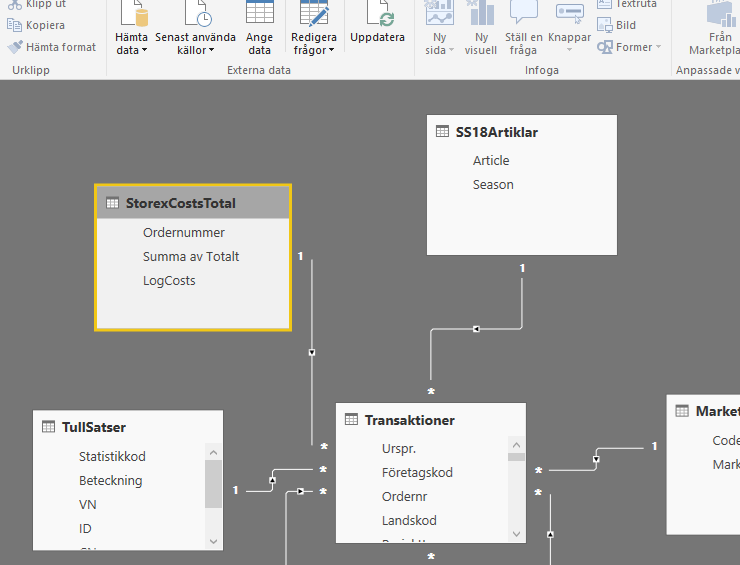

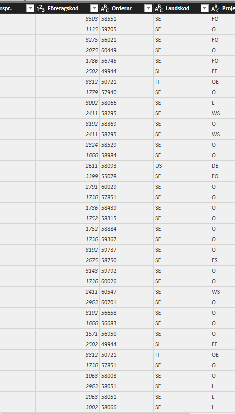

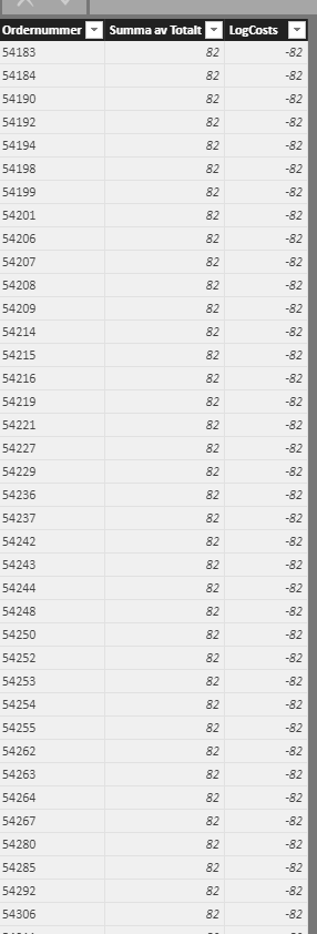

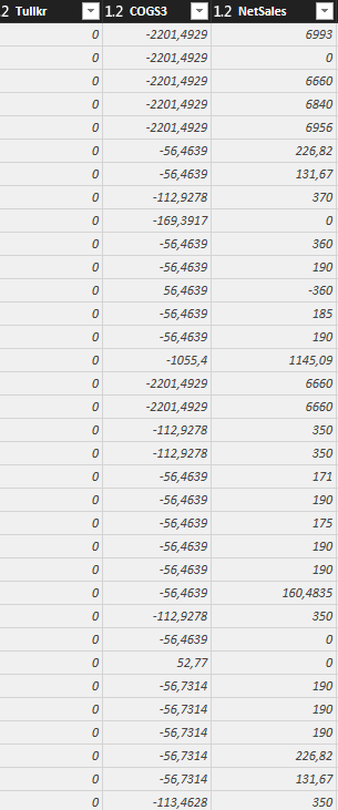

The relationship: Two tables are called "transaktioner" and "StorexCostsTotal"Relationship between the two tablesRelationship between the two tablesTable1: transaktioner. Showing the COGS value - which I would like to add with the value LogCosts from Table 2: StorexCostsTotal (see next screen shot)Table1: transaktioner. Showing the COGS value - which I would like to add with the value LogCosts from Table 2: StorexCostsTotal (see next screen shot)Table1: transaktioner. part 1Table1: transaktioner. part 1Table2: StorexCostsTotal: ordernumber is uniqueTable2: StorexCostsTotal: ordernumber is unique
So on a total cost level it works: see below:The total for everything is correctThe total for everything is correctIf I try to divide the data into any categories - it becomes wrong (same amount in every category)If I try to divide the data into any categories - it becomes wrong (same amount in every category)
