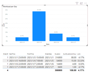

I want to ask how I can calculate the duration correctly on the time of occurence. For example I have sample data in the screentshot. Its about a machine which is constantly fetching boxes and only can do one order after another. So it should be clear that this machine cannot work more than 24hours per day or exceeds a workload per day of more than 100%:
I take Order No. 1234 as an example: It's an order which lasted 88 hours. But only 1 hour of that duration time occured on January 1st, because it started an 2021-01-01 11PM. The problem I have is that the two bar charts aren't reflecting the right hours per day nor the right workload per day. Because the duration always falls completely on the day where the order started, which is StartTime. So the one hour workload for 2021-01-01 should be resulting in a workload of 1/24, which is 4,2%, 100% for each days in between and 15hours/24 =62,5% for that day where it finished. (2021-01-05 15PM=15 hours workload that last day)
On the otherside Order No. 1237 just lasted 1 hour but also finished within the same day, so no problems here.
I hope there is a possiblity to calculate so that the hours are correctly allocated to date of occurence.

Hello @v-henryk-mstf, thank you very much for the effort. The values are still not correct. As you can see the first order spans over 3,5 days, but between the 2021-01-01 and 2021-01-05 are not bars. The time we got returned here, are also not how it should be displayed.
I try to describe in detail:
OrderID 1234 last 88 hours in total. It started on 2021-01-01 at 11PM. The first chart is correct, since 1 hour is allocated to the first starting day: 1hour/24hours are 4,17%
Afterwards there should be 3 other bars for 2021-01-02 until 2021-01-04 each day 100% workload. On 2021-01-05 which is the last day of that order, the machine runs 15 hours, so in workload percentage result in 15/24 =62,5%.
The most important thing is, that the machine runs orders one after another, but never at the same time, which actually returns clear data.
I hope there is a way to compute it that way and also for the other orders. Of course a order can also start and finish same day.
Best regards.
