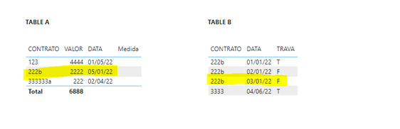

Hello everyone, I have a TABLE A where I have a date, I need to get the TRAVA field of TABLE B with the date equal to or before the date of table A
I am not able to find a solution for this.
Example Power Bi
Thank you for your help

thanks for the help but I needed to return the same date or before the date. In the example contract 222b has the date jan/05, the same or earlier date would be jan/03 and the result would be F
