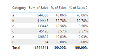

Have you solved this problem? If yes, you can accept an appropriate reply as solution or post your own solution. If not, you may refer to my sample file attached at bottom. Usually providing some sample data or sample file will make other users understand your data and expected result better.
If you have a column [Sales] in table 'Table', you can try a measure like below.
% of Sales = DIVIDE(SUM('Table'[Sales]),CALCULATE(SUM('Table'[Sales]),ALL('Table')))
If you already have a measure like [Sales Measure] which calculates the sum, you can create a new measure like
% of Sales 2 = DIVIDE([Sales Measure],CALCULATE([Sales Measure],ALL('Table')))
