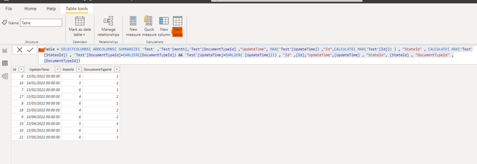

Hi, @Syndicate_Admin
According to your description, you want to filter the table by grouping by month according to [documentid]. Right?
(1)This is my test date:
(2)We can click New Table at the top of the interfaceand enter :
Table =
SELECTCOLUMNS (
    ADDCOLUMNS (
        SUMMARIZE (
            'Test',
            'Test'[month],
            'Test'[DocumentTypeId],
            "UpdateTime", MAX ( 'Test'[UpdateTime] ),
            "Id", CALCULATE ( MAX ( 'Test'[Id] ) )
        "StateId",
                MAX ( 'Test'[StatedId] ),
                'Test'[DocumentTypeId] = EARLIER ( [DocumentTypeId] )
                    && 'Test'[UpdateTime] = EARLIER ( [UpdateTime] )
    "Id", [Id],
    "UpdateTime", [UpdateTime],
    "StateId", [StateId],
    "DocumentTypeId", [DocumentTypeId]
(3)Then we can get the table you need:
If this method can't meet your requirement, can you share sample data and sample output in table format? Or a sample pbix after removing sensitive data. We can better understand the problem and help you.
