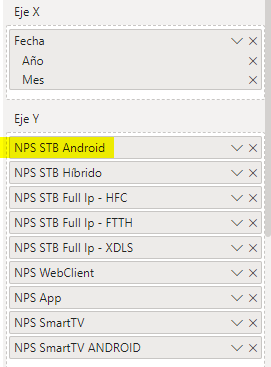

I have a rare problem with the data labels of a line graph, but it also has a problem with the charting of areas and stacked areas. The label of the first value of the Y Axis always appears (??!). If I modify that first data of the Y axis, the label that always appears accompanies.
Case:

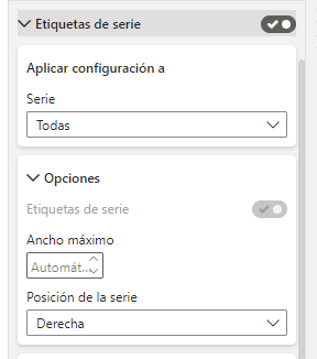

Label display settings

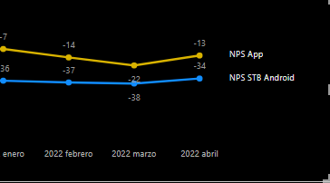

Chart display
Can you tell me if it is a mistake or if there are any additional settings that I am passing?

Hi @Davoo0o ,
Sorry, not very clear.
What does ’The label of the first value of the Y Axis always appears (??!). ‘ mean?
Does it mean that the fields you marked with yellow always appear? Can't remove fields?
