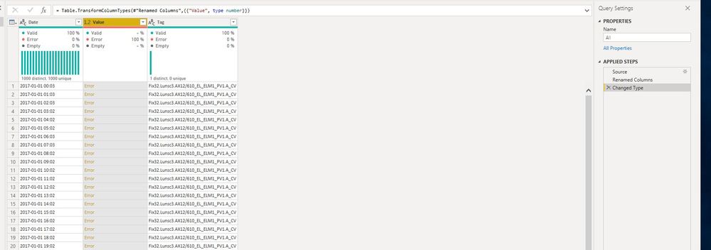

I tried to convert one column, which has been automatically exported as text, to decimal number, but I got below error. Do you know how I can fix this?
@ehsanbh , check for space.
Create a new column with Text.Trim and convert it to decimal and see if it works. It means it's a problem to have white space.
if necessary, see how to handle the error in the power query

I read the solution but still cannot solve this problem. My number is like this 123,456 and when I change data type in power query, the whole columns show errors. What do I have to do? Thank you
Replace the "," with nothing and redefine the variable type

I had the same mistake and solved it like this:
1. Enter the query edit
2. Right click on a column cell and Replace values " " for nothing
3. Under Data Types change text by number
I had the same problem and it is my solution:
1. Enter to the query
2. Right clic on a cell in the column, replace values " " for nothing
3. Change tipe of variable for number
Its work

@AllisonKennedy Trim worked perfectly! Thanks a lot. These are electricity data I am reading from a CSV file.
