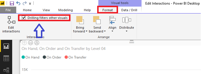

I have one stacked bar chart with drill down capabilities and I have matrix chart too. I want filter down everything on matrix chart when I drill through on stacked bar chart, but I turn on the drill through it does not.  Is there any other way I could make this happen or Am I doing something wrong here?

Hi @Anonymous,
That isn't the job of "Drill Through". Maybe you can try this new feature “Drilling filters other visuals”. Please refer to this idea.

Hi @Anonymous,

@v-jiascu-msft
Thank you so much. I will try that
