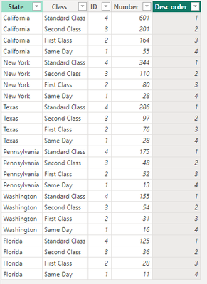

Hi @anshusaketsingh ,
The link can’t be opened.
Please try the following methods:
1.Create the simple table.
2.Create the new column to sort desc.
Desc order =
VAR stat = 'Table'[State]
RANKX(
    FILTER('Table', 'Table'[State] = stat), 'Table'[ID], ,DESC, Skip
3.Drag the field into the matrix visual. Select the Class field, and choose sort by column feature and select new column.
4.The result is shown below.

The solution unfortunately doesn't seem to wirk because the ids are not unique as in your with my workbook.
