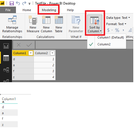

Hi @ABNHS84,
Power BI has a trick indeed. Please refer to the snapshot below. You just need to add a numeric column to indicate the orders.
Does-anyone-know-how-to-restrict-sorting-to-only-valid-numbers\
