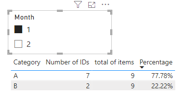

    Hi Anonymous ,
    According to your sharing sample, here are my test process
    To achieve your goal, you can follow these steps:
    Here are my test data
    1.Create a measure by using DAX
    Number of IDs = COUNT('Table'[ID])
    total of items = COUNTROWS(ALLSELECTED('Table'))
    Percentage = DIVIDE([Number of IDs],[total of items])
    2.Create a Slicer by using month
    3.Final output
    I hope my solution can help you, but if it doesn’t, don’t worry. You can always share your thoughts and feedback with me by posting a comment below this post.
    In order for you to solve the problem faster, you can refer to the following documentation
    How to Get Your Question Answered Quickly - Microsoft Fabric Community
    Albert He
