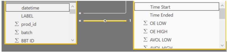

Please find below the two tables I have. Here I am trying to match the date in "Date" table with the appropriate date range in the SPECS table (the same as the quarters table I mentioned before) and get the related outcome depending on the match.
In my formula I can only choose from the SPECS table and not from the DATE table, so I cannot choose the data field date to compare it with Time Start field.
The formula I have is the below
AlB
Hi @Anonymous
probably because you're filtering the Quarters table and there you cannot reference a column on the Calendar table. What row of that table are you referring to? None.  So the engine cannot determine a value and therefore it is trying to avoid that you write it.
What are you trying to do exactly with Calendar[Date]? Maybe if you explain that we can help
