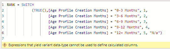

      Thanks but something isn't working right with my code:

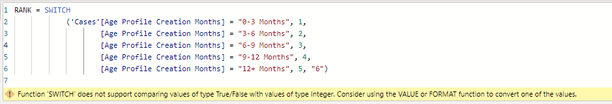

    This is my other attempt based directly on what you suggested
    • johnt75's avatar
      johnt75
      replace the "N/A" with 6. You can't return an integer and a string into the same column.

        It still has the same error when N/a is replace with 6
