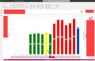

I have a report with data labels. See the following screenshot
When I start the report view in Power BI Service the data labels are not visible...
like this...
After using a slicer on the report page the data labels are visible again.
Is this a report rendering issue ?

Thank you for all your hints.
Nevertheless, the problem occurs also in PBI Desktop (not only in Browser/PBI service),
and the data labels are shown by clicking on a slicer...
Yes, I use bookmarks in my report.
See following screenshots (company special information are hidden by red boxes) ...
After opening the report...
After clicking on a slicer
@bh65 That is happening because of Bookmark. First enable the label then save the bookmark of that page with this state.
Because Bookmark is used to save the state of the report page. So, it will solve your issue just updating the bookmark with data label on state.
Don't forget to give thumbs up and accept this as a solution if it helped you!!!
Please take a quick glance at newly created dashboards : Restaurant Management Dashboard , HR Analytics Report , Hotel Management Report, Sales Analysis Report , Fortune 500 Companies Analysis , Revenue Tracking Dashboard
Unfortunately no improvements
1.) I deleted all bookmarks in the report.
2.) I switched the datalabels in the chart settings off
3.) I switched the datalabels on
4.) I set up all bookmarks again
5.) I published the report to the service again
By opening the chart still appears without datalabels (in report and desktop app).
After clicking on any slicer in the report the datalabels appear.
I still have a question.
Do I have to delete all bookmarks on this page ?
Because I have also bookmarks with option "selected visuals" enabled and bookmarks with  option "data" disabled....
