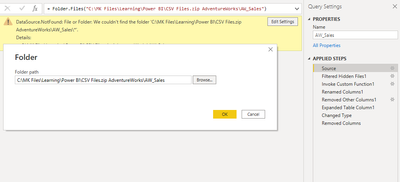

Hi, I'm not able to change file location as it is giving me the option to select folder not file

Hi Meena,
As per the PowerQuery steps on right side form above image, the current query connected to folder not to a specific file.  You can connect to the requried file in a new query and replace existing (folder) code with the new powerquery in advance editor.
