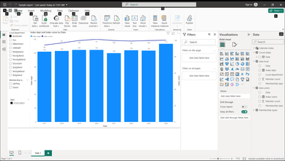

DAX causing problems calculating dynamic indices base 100

I think if you try changing the aggregation functions MAX instead use SUM.
From the suggestion you have shared - I think if you make these changes your output will change - as when you select multiple member types it has to get the sum instead of maximum value.Index Local dept = VAR Date_index = MIN ( 'Calendar index'[Date] ) RETURN SUM ( 'Index local'[Member count] ) / CALCULATE ( MAX( 'Index local'[Member count] ), 'Index local'[Date] = Date_index ) * 100Index Union = VAR Date_index = MIN ( 'Calendar index'[Date] ) RETURN SUM( 'Index Union total'[Member count] ) / CALCULATE( MAX ( 'Index Union total'[Member count] ), 'Index Union total'[Date] = Date_index ) * 100

- EBoklund2 years agoFrequent Visitor
Thank you! It solved the first part of my problem. The second part (the line graph for the union total) is still off the charts, though, albeit no longer infinite. I found out that the infinity problem was caused by PBIs autorelation function. I removed the automated relations, but it still doesn't index correctly for the line chart.

Appreciate your Kudos!! Happy to Help!- EBoklund2 years agoFrequent Visitor
I see your point. However, when I do the suggested - create a new calendar, relate it to both of the queries' data columns, and use that date on the x-axis, it causes both the bars AND the line to go bonkers again and return infinite numbers, except for the index base year.
