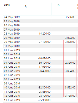

I require help in getting AVG of the last 5 nonblank values from column B. My table is setup like this:
Table
So, pickup values 3788, 3522, 3604, 2326, 3058 and then avg it.

I would suggest this measure - a slight modification of the above reply that ensures the top 5 dates are taken from those where B is not blank:
Average of B Over Last 5 Nonblank Dates =
VAR Last5Dates =
    CALCULATETABLE (
        TOPN ( 5, VALUES ( YourTable[Date] ), YourTable[Date]  ),
        NOT ISBLANK ( YourTable[B] )
    CALCULATE ( AVERAGE ( YourTable[B] ), Last5Dates )

Hey Ranbeer,
CALCULATE(AVERAGE(Table1[ColumnB]), // Col b is nmberic that we want avg for
TOPN(
5,
Table1,
Table1[Date])
Hello!
The CALCULATE expression allows you to compute values based on certain filters, more info here.
So you would say
CALCULATE(AVERAGE(Column Name),Column Name<>BLANK())
And then in order to select the last 5 measures, you can select the column name in the filters selection > Select ‘Top N’ in the drop-down > switch it to Bottom > enter 5.
Or if you have ranked the column by date, and on the filter, select whichever ones you want by adding another filter to the CALCULATE measure:
CALCULATE(AVERAGE(‘Column Name’),’Column Name’<>BLANK(),’Date’ > (Specific Date))
