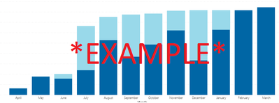

However, I would like to split this by category in a stacked bar graph. Whenever I try and add a data field in the legend, it doesn't seem to be splitting up the allocations correctly:
This second graph should ideally show the same total values as the first one, only split by status, ideally looking something like this:

1. Create three calculated columns to sort the months of the chart by year.
Month = MONTH([Date])
Year = YEAR([Date])
Year-Month = [Year]&"-"&[Month]
2. You can write your measure as below. I changed ALLSELECTED to ALLEXCEPT.
Running Total MEASURE =
    SUM ( 'Data'[Savings] ),
    FILTER (
        ALLEXCEPT ( Data, Data[Categories] ),
        Data[Date] <= MAX ( Data[Date] )
You can check more details from here.
