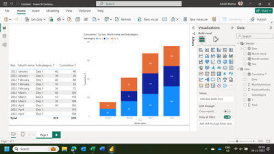

So i have basically done what is asked for in this post but as a bar chart:
https://community.fabric.microsoft.com/t5/Desktop/Problems-with-formula-for-creating-cumulative-coun...
This works for me
Now in my table are multiple subcategories for each entry which i also want to include in the visual.
For example if my table looked like this:
| Date | Total | MonthlyAmount | Subcategory | RuntimeMonths |
| Jan 22 | 40 | 4 | Dep 1 | 10 |
| Jan 22 | 36 | 3 | Dep 3 | 12 |
| Feb 22 | 55 | 5 | Dep 2 | 11 |
| Feb 22 | 40 | 4 | Dep 1 | 10 |
| Feb 22 | 36 | 3 | Dep 3 | 12 |
| Mar 22 | 55 | 5 | Dep 2 | 11 |
| Mar 22 | 40 | 4 | Dep 1 | 10 |
| Mar 22 | 36 | 3 | Dep 3 | 12 |
| Apr 22 | 40 | 4 | Dep 1 | 10 |
(The total is also the key attribute)
The visual i currently have would be this:
But i want to see which department is responsible for which part of the monthly amount. So i try to add the subcategory as legend and this happens:
Since some departments dont have any impact in april the acumulated values also dont get added to the sum in april.
How can i always keep the complete cumulative value in each month and also show the subcategories?
If anyone could help it would be greatly appreciated!
PBI file attached.

Change the calendar table formula to
Calendar = CALENDAR(MIN(Data[Date]),MAX('Future Data'[Date]))
Hope this helps.

For Dep 3, information is available only for JFM 2026. There if i swap Year and Month on the X-axis, this is the image i get (with which i see nothing wrong)
Yes, but i need ALL of the monthly amount to be added up in every month after they are added.
In the ss you shared it resets after each year. I would like it to carry on the data from the previous years and departments.
Yes, thank you very much thats what i have been looking for.
