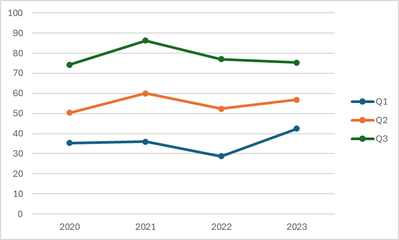

And in Excel, you can calculate the percentiles then create a graph that looks like this:
Is there a good way to go about this in Power BI? Or do I have to create a measure for each quartile and compile them all together? I ask because I need to create three of these graphs, with three different datasets and each column is actually a measure (sum by ID). So I would end up with 27 measures just to create three graphs (each quartile needs a measure, each value column needs a measure)

Gerbil , I am assuming Quarter is on rows. Unpivot the data to have years on the row.
Then you can have Year on Axis and Quarter as legend
Unpivot Data(Power Query): https://youtu.be/2HjkBtxSM0g
