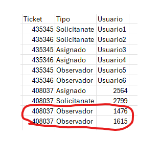

I want to create a new table by copying the information from another table as follows:

Thank you very much an additional query appears to me as follows, there is some way for the assignee and requester data to appear in a single row and not two as shown.
An additional query appears to me as follows, there is some way for the assignee and requester data to appear in a single row and not two as shown.

I have tested the data you provided in the case, and the test results are the same as those shown in the Vallirajap user. The test results are as follows:
At the same time, if the Ticket id has more than four items, the pivot will fail as shown in the following figure:
We must provide a unique value for each column corresponding to ticket id instead of multiple values. If you can provide sample data that does not contain privacy or describe your pivot operation process in detail, I will further analyze the reasons for your additional queries.
