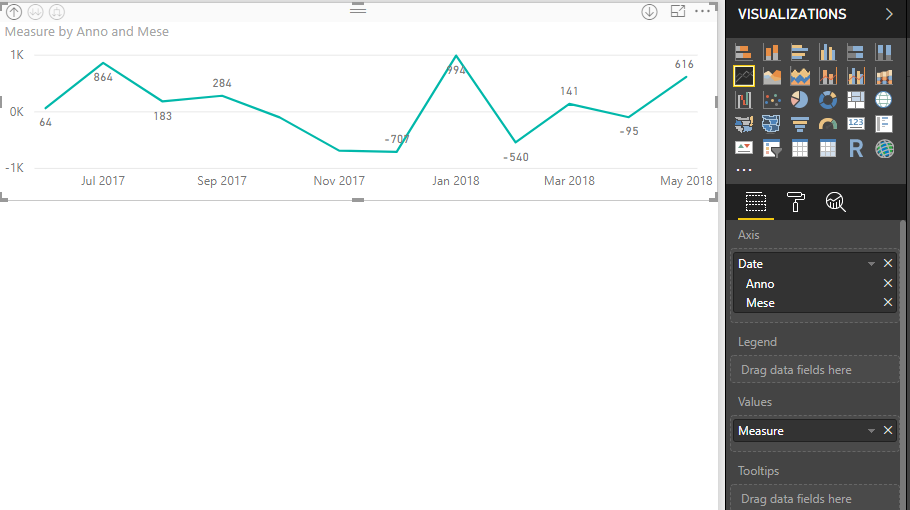

Hi @AlexEners,
Please check out the demo in the attachment.
1. Create a date table.
2. Create TWO relationship. Please check it out in the demo.
3. Create a measure.
Measure =
COUNT ( ActivedPoint[DataInzioFornituraMese] )
    - CALCULATE (
        COUNT ( ActivedPoint[DataSospensioneFornituraMese] ),
        USERELATIONSHIP ( ActivedPoint[DataSospensioneFornituraMese], 'Calendar'[Date] )

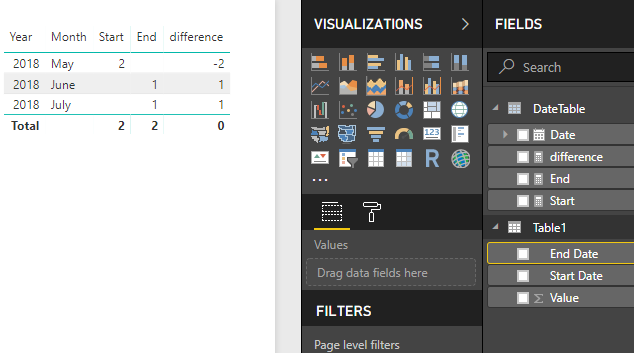

Since you want to put two different date fields in one visual, you would need a new date table if you don't have one. Then establish relationships to "StartDate" (date) and "EndDate (date)". But only one relationship is active for this time.
Finally you can use a measure like below. Please try out the demo in the attachment.
difference =
    COUNT ( Table1[Value] ),
    USERELATIONSHIP ( DateTable[Date], Table1[End Date] )
    - COUNT ( Table1[Value] )

Hi @AlexEners,
Measure =
    - CALCULATE (

Hi @AlexEners,
No, you can't create a new table in the Direct Query mode. Maybe you can create it in the data source. Due to the two dates are in two different columns, you need a date table to bring them together.
