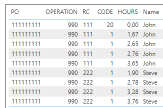

I have table with data about production orders, which is combination of two tables - Person and Data. After activation of few filters table looks like this:
As you can see on PO 111111111 worked 2 operators - Steve and John. what I want to achieve is that after filtering of the data I will get one row with number of operators worked on specific PO:

Try this measure
Measure = if(ISBLANK([Number of operators]),BLANK(),CALCULATE([Number of operators],ALLEXCEPT(Data,Data[PO])))
