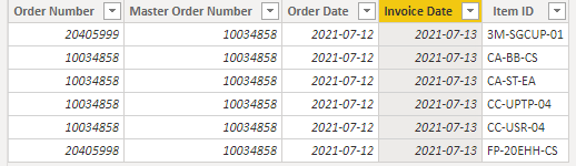

@lbendlin thanks for the reply.
Table 1: Sample of data before filter showing all the order IDs within Master Order # 10034858.
| Order Number | Master Order Number | Order Date | Invoice Date | Item ID |
| 10034858 | 10034858 | 7/12/2021 | CA-ST-EA | |
| 10034858 | 10034858 | 7/12/2021 | CA-BB-CS | |
| 10034858 | 10034858 | 7/12/2021 | CC-USR-04 | |
| 10034858 | 10034858 | 7/12/2021 | CC-UPTP-04 | |
| 20405998 | 10034858 | 7/12/2021 | FP-20EHH-CS | |
| 20405999 | 10034858 | 7/12/2021 | 3M-SGCUP-01 | |
| 10034858 | 10034858 | 7/12/2021 | 7/13/2021 | CC-USR-04 |
| 10034858 | 10034858 | 7/12/2021 | 7/13/2021 | CC-UPTP-04 |
| 10034858 | 10034858 | 7/12/2021 | 7/13/2021 | CA-ST-EA |
| 10034858 | 10034858 | 7/12/2021 | 7/13/2021 | CA-BB-CS |
| 20405998 | 10034858 | 7/12/2021 | 7/13/2021 | FP-20EHH-CS |
| 20405999 | 10034858 | 7/12/2021 | 7/13/2021 | 3M-SGCUP-01 |
Table 2: Data after filter applied; duplicate order IDs within Master Order # 10034858 WHERE Invoice Date = NULL have been removed.
(Remember I want this logic to look within all Master Order #s. I have just filtered down to one Master Order # to simplify the example output.)
Thanks again.

Hi @Anonymous, thank you so much for the reply and for taking the time to help me out. I think this gets me closer but it's not quite what I need. I may not have explained it very clearly, but I only want to suppress rows when the following conditions are met:
So consider the screenshot below. The ones highlighted in green should be removed, and the white ones left alone, which your script did perfectly.
But the yellow ones I highlighted, which are part of a different Master Order #, should not be removed because they do not have duplicate Item IDs nor do they have a blank Invoice Date. So I don't want to remove the yellow rows. Does this help clarify what I am asking for?
