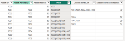

After thoroughly reviewing the details you provided, I was able to reproduce the scenario, and it worked on my end. I have used it as sample data on my end and successfully implemented it.
Output:

Thank you so much for your help and suggestions on handling the scenario I was working on.I tried both of your suggestions, and @v-kpoloju-msft  your solution worked well for me. However, there was just one thing I noticed, it wasn't capturing the highest parent’s DescendantsList and DescendantsMinHealth value. As shown in the example I provided earlier:
  • If I select Asset ID = 1000, I need to calculate the minimum asset health value from its descendants : 1001,1002,1003,1004, 1005, 1006,1007, 1008, 1009.
In this case, for Asset ID 1000, it’s not calculating DescendantsList and DescendantsMinHealth value correctly.
To address this, I updated the DAX expressions used to create the calculated columns as follows and this now includes the descendants even for the highest-level parent.

This approach now correctly returns the DescendantsList and DescendantsMinHealth value for the top-level asset as well.
