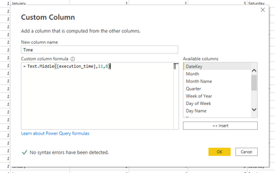

Hi @hankmobley, the formula should read Text.Middle([execution_time],11,8). The "=" sign is there by default.
Delete the Parse Time and other "=" sign

Hi @hankmobley , I see. I thought from your original post, you would need to parse out the time from the cell ending in AEDT 2022. In your example above, you should be able to convert the column to a time and then just apply the case statement in a custom column.
I don't think something as simple as this would force an import but if it does, we may have to try the DAX route.
So convert exection_time to time and then add a custom column as below
= if [execution_time] > Time.FromText("09:00:00") and [execution_time] < Time.From("18:59:00") then "Day" else "Night"
