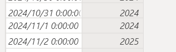

maybe you can try this to create a fiscal year column
fiscalyear = SWITCH(TRUE(),
'date'[Date]<date(2024,11,1) &&month('date'[Date])<11,year('date'[Date]),
'date'[Date]<date(2024,11,1) &&month('date'[Date])>=11,year('date'[Date])+1,
'date'[Date]>=date(2024,11,1) && (month('date'[Date])<11||(month('date'[Date])=11 && day('date'[Date])=1)),year('date'[Date]),
year('date'[Date])+1)

I already created a datetable with fiscal year column listed "2023","2024“,"2025" .
Can you please show me a formula using that column to calculate fiscal year to date value?
Thank you
