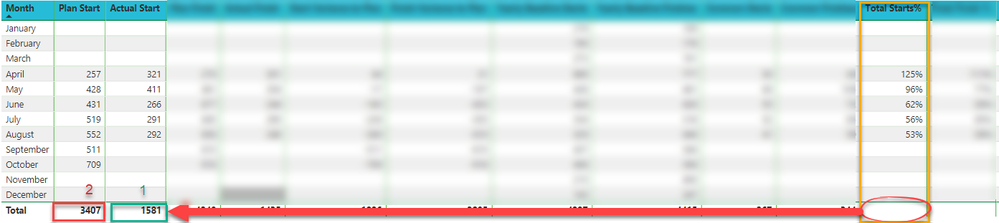

Hi all,
The problem I ran into I want to divide Actual Start over Plan Start (Actual Start divide Plan Start)
This is the calculated Actual Start Total, thanks to @Greg_Deckler
https://community.powerbi.com/t5/Desktop/How-to-Calculate-Total-Column-When-is-Not-Displaying-the-To...
Actual Start =
VAR __table = SUMMARIZE(MonthTable,[Month],"__value",[Actual Start])
IF(HASONEVALUE(MonthTable[Month]),[Actual Start],SUMX(__table,[__value]))
This is the calculated Plan Start Total
Plan Start =
VAR __table = SUMMARIZE(MonthTable,[Month],"__value",[Plan Start])
IF(HASONEVALUE(MonthTable[Month]),[Plan Start],SUMX(__table,[__value]))
Now for the Total Finish%. I would like to count the difference Total by divide Actual Start Total over Plan Start Total to get Total Finish% total and not the total of the column
How should I write this function? Do I need to create a new measure for that?
Thanks guys ^^
Greg_Deckler
I may be incorrect, but I am thinking that you could create a new measure like:
Total Finish % = DIVIDE([Actual Start],[Plan Start],BLANK())
Should work in the context of ALL (total row) and individual rows. You would format it as a %.
