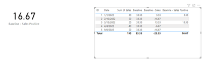

Also I want to display a KPI Score card having Total of only Positive values from Baseline - Sales
I used If condition and wrote below formulae but it's showing Total as 0.
Can you please check and correct the formulae
Thanks in advance.
Appriciate your help!
Hi @nr_m
try the following code:
Baseline - Sales Positive =
SUMX( FILTER(ADDCOLUMNS(Sales, "base", [Baseline]), Sales[Sales] <= [base]), [base] - Sales[Sales])
If you want to show the others has 0 then redo the formula to:
SUMX( FILTER(ADDCOLUMNS(Sales, "base", [Baseline]), Sales[Sales] <= [base]), [base] - Sales[Sales] )+0
Regards
Miguel Félix
