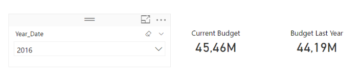

I have a data that goes from 2008 to 2020 with real and Budget sales.
The client wants to see the current and last year budget while selects the year in a filter, like the image:
But the problem is when no year is selected; the image should show the sum of budget for all years and the budget for the previous year of the last year with data (not necessarily has to show budget for 2019). Am I explaining well?

The only thing I would like to have is MAX PREVIOUS YEAR when no filter is selected.

But the problem is that the max year does not have data, it is to say, my date range goes from 2008 to 2020, but the max year with budget data is 2016. When no year is selected on the filter I need to show the budget for 2016 dynamically (the latest year with data).
