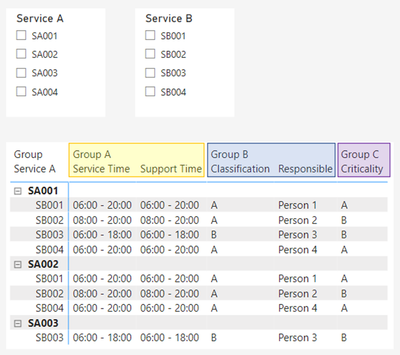

The requirement I must achieve is a matrix which:
  • Has a hierarchy with Service A and Service B (as Rows)
  • Shows the different attributes from Service B (as Values)
  • Groups the different attributes with an additional parent "Group" (as Columns):

  • Hi , PBI-Enthusiast
    According to your description, you want to get this table . Rught?
    For your needs, your Service A belongs to one end table, and the rest belongs to the fact table. I don't recommend that you use many-to-many relationships to maintain your inter-table relationships.
    I use the following table relationship:
    I create the 'Service A' table in Power Query Editor:
        Source = Table.Distinct(Table.SelectColumns(#"Fact Table" ,{ "Key A","Service A","Service A Description" }))
        Source
    And we need to unpivot the fact table :
        Source = Table.FromRows(Json.Document(Binary.Decompress(Binary.FromText("rZHPCsIwDMZfZfQ8IUmzWr2tTyB4HDv476qgB6dPbxPr5sApQj8oX1Lo72ubpjGIaEqzrgHEN6pYIFnZDs/tqyoW4JYAxawgiP6hr+NaHc6X07FAbdtyMoIrlyIoeicSoldiHzBu3/hyKHzjz/0i8eUpN9FwY/SjB7zaMPDtL76rOPHF76L/foj7HyKilCC+VWUewkREtiFYaxNffKfKOQRmTnzxvSrjENoH", BinaryEncoding.Base64), Compression.Deflate)), let _t = ((type nullable text) meta [Serialized.Text = true]) in type table [#"Key A" = _t, #"Service A" = _t, #"Service A Description" = _t, #"Key B" = _t, #"Service B" = _t, #"Service B Description" = _t, #"Service Time" = _t, #"Support Time" = _t, Classification = _t, Responsible = _t, Criticality = _t]),
        #"Changed Type" = Table.TransformColumnTypes(Source,{{"Key A", Int64.Type}, {"Service A", type text}, {"Service A Description", type text}, {"Key B", Int64.Type}, {"Service B", type text}, {"Service B Description", type text}, {"Service Time", type text}, {"Support Time", type text}, {"Classification", type text}, {"Responsible", type text}, {"Criticality", type text}}),
        #"Unpivoted Columns" = Table.UnpivotOtherColumns(#"Changed Type", {"Key A", "Service A", "Service A Description", "Key B", "Service B", "Service B Description"}, "Attribute", "Value")
    Then we apply the data to Power Bi Desktop ,here are the steps in Power Bi Desktop you can refer to :
    (1)We need to click "New Column" to  create a calculated column in 'Fact Table':
    Group = IF([Attribute] in {"Service Time","Support Time"} , "Group A" , IF([Attribute] in {"Classification","Responsible"} , "Group B" , "Group C"))
    (2)Then we need to add a hirearchy in this table:
    We can click the three dots in the right of the 'Fact Table'[Group] and click 'Create hirearchy' and then add the [Attribute] to this hirearchy.
    (3)Then we can create a measure:
    Measure = IF( HASONEVALUE('Fact Table'[Service B]) , MAX('Fact Table'[Value]))
     (4)Then we put the field we need on the Matrix visual and then we can get this:

  • With the special grouping requirements your only option is to create dedicated measures for each of the "columns" of your matrix. This will include more development and maintenance work.
    The ideal solution would be to abandon/modify your requirements and use the standard functionality of the matrix visual.  "Don't fight the API".

    • PBI-Enthusiast's avatar
      PBI-Enthusiast
      Hi v-yueyunzh-msft
      Thank you very much for taking the time to analyse and answer my question. Your solution uses an unpivot, which I was trying to prevent. But when I "define" this unpivoted table as a fact table, I guess the further requirement (additional fact tables related to Dimension table "Service A") will be possible that way.
