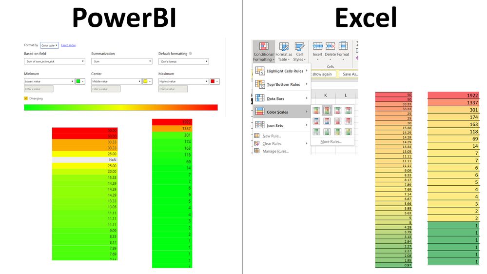

I'm trying to get a table in PowerBI to format the background color in a table based on the sum of values. It works, but the color variation looks very differentnet than in the same table in Excel. The Excel table has a much wider range of yellow and orange colors "between", while the PowerBI is almost entirley green or red. However, it should work the same way because the scale on both is red-yellow-green. Any idea how to change this?

Hi @Anonymous ,
We can use the following steps to meet your requirement.
1. Create a measure to rank the value.
rank =
IF(
    HASONEVALUE('Table'[name]),
    RANKX (
            ALLSELECTED('Table'),
            CALCULATE(SUM('Table'[value])), ,
            ASC,
            DENSE
2. Then we can create a measure to calculate the percentage of column.
Measure = CALCULATE([rank]) / MAXX(ALLSELECTED('Table'),[rank] )
3. At last, we can configure the value’s background color based on measure.
We can get the result like this,
BTW, pbix as attached.
