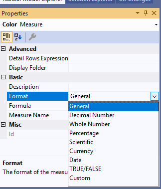

I guess what the problem might be. In the conditional formatting pane, you can only select fields and measures that are in text format, and in ssas-cube my measure has a general format. How to specify the text format for the measure in the tabular model (compatibilityLevel = 1400)?
Click on the measure and in the Properties pane you should be able to change the format to text
This is the problem, the option Text in the list is missing
Not sure what the problem is...I have a similar color coding measure in an AAS data model.  Format is general and I have no trouble with it

I tried to create a new report in PowerBI that uses data from the same cube and in this case there was the same problem
