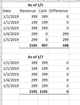

Below is an example of how the source data can look from one day to the next, the cash column updates as payments come in and my client is concerned with the Difference column. I need to create a calulation that lets my client choose a date and see what the cash column looked like on that date. For example if it was January 7th and my client wanted to see the data as of January 3rd the calculation would change rows 4 and 5 (in the Cash column only) to zero to show that we had a Difference of 598 as of January 3rd.

The data source updates the existing rows when Cash comes in, so if I choose the 5th, any rows with a date after the 5th need to be multiplied by zero.
It is a very simple calculation in tableau, essentially all I need to do is say if the date in my data source is greater than the date chosen, then multiply the cash column times zero. I just can't figure out how to create an independent date parameter
