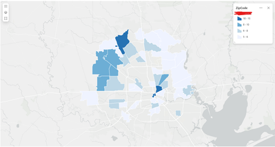

ArcGIS Map not updating class min/max values automatically
I have an ArcGIS map in my report that I have set up to use "Natural Breaks" for color classification. However, I have noticed that the min/max values for each class do not automatically update when I refresh my data or apply any slicers/filters. I have to manually toggle the number of classes every single time I refresh for the classifications to update to reflect my new data. And then I have to manually close the layer key displayed on the map and re-open it for the numbers to reflect the updated class values. I'd really like this to be an automatic process since my dashboard is meant to be published.
I have seen threads where this has been identified as a bug previously but have not seen how to resolve this issue. Has anyone been able to fix this or create an easy workaround?

Hi @ksheth,
Thanks for reaching out to the Microsoft Fabric Community forum.
Manual Refresh of Class Breaks
To force ArcGIS Maps to recalculate min/max ranges:
Open the Symbol style pane.
Change the Number of classes (e.g., from 5 to 4), then switch it back.
Or switch the Classification method to a different one and revert to the original.
This forces ArcGIS to re-evaluate the dataset and update the class breaks, but it is manual and not suitable for published reports.

Thank you for your response. It seems like I'll need to look into one of the alternatives because it is critical to my report that the classification thresholds are dynamic and update with each refresh.
Are there any plans to address this issue with ArcGIS maps? It seems like this is a feature that many people have been requesting...

Hi @ksheth  - create a DAX-calculated custom classification that groups values based on percentile or custom logic.
eg:
ZipCode_Group =
SWITCH(
TRUE(),
[Value] <= 3, "Low",
[Value] <= 7, "Medium",
[Value] <= 11, "High",
"Very High"
use this for color classification column, instead of measure.

Hi Rajendra,
Thank you for the suggestion, but I do not want static cut-off values. I need them to update dynamically based on how my data changes each week. Do you have any suggestions for this?

Hi @burakkaragoz ,
Thank you for your suggestions. I have actually tried using quantiles as well, but I experience the same problem of the class threshold values not updating automatically. I still have to manually toggle between the number of classes.
I'm not super familiar with the other mapping options you mentioned (still a bit of a newbie to PowerBI), do you have any more information you can share?
