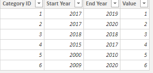

I build a sample table to have a test.
Sample Table:
My YearSlicer is from 2000 to 2020.

When I select 2018, it should show values which ID = 1,2,3,6
