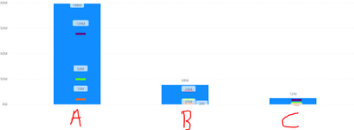

I have to create a visualisation where on x axis I have 3 categories which has our business ( we are showing the spend amount for all the 3 category) now for example concider i have 3 categories A, B and C. In category A we are spending 80% of our total spend, in category B we have 15% of the total spend and category C has the remaining 5% as its spend value which is being shown on a bar. Now we want to keep the target as: For category A 25% of the total spend should be the target for category A, 70% of the total spend should be the target for category B,and 5% of the total spend should be the target for category C.
So, what i want is multiple target values ( target changes for all three category) I have created 3 measure to capture all the targets. Now if I update the target on combo chart (eg: if I have target for category A, it also shows on B and C) if I try to add filter on the category also puts the filter on the total spend amount giving incorrect value. beacuse of which my chart looks like :
each category target visible for all category type.

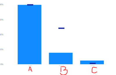

Can someone please help me create formula for the target lines and which visualisation would support it. trying to achive a visualisation shown below. where the target value only comes for there category type.
I am using formulas like:
for target value
And to show the target based on the total spend value I also made a measure:
Begin Date | Category | Spend |
3/20/2023 | A | 10748 |
5/30/2023 | C | 5259 |
5/16/2023 | C | 62733 |
7/5/2023 | A | 5701 |
4/11/2023 | A | 108120 |
8/4/2023 | B | 103131 |
3/16/2023 | A | 1246.98 |
4/12/2023 | A | 21398 |
5/16/2023 | A | 79695.32 |
@Anonymous , Create a measure and use that as a line in line clustered bar visual
Target =
var _m = calculate([Measure], allselected())
return
Switch(Max(Table[Category]) ,
"A", _m*.75 ,
"B", _m*.20 ,
_m*.05
and use this measure as line , enable marker and use line width =0
